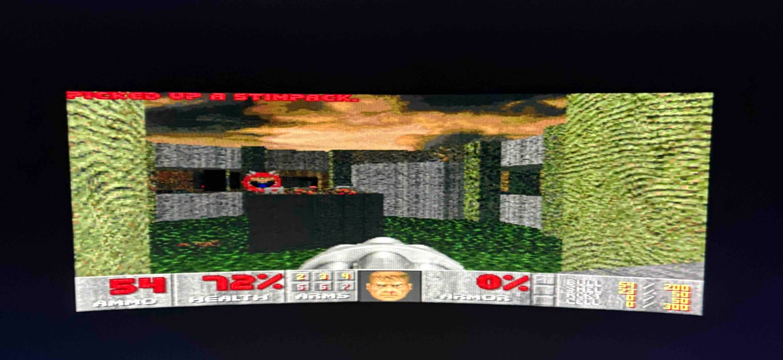

Thanks for the reply. I tried your suggestions, but there was no improvement.
I attempted to launch `doom.gtp` with the parameters `-width 320 -height 240`, and the result is shown in the attached image: Doom runs well, even though the screen size is reduced.
I suspect that the parameters for 320x200x8 are out of range...

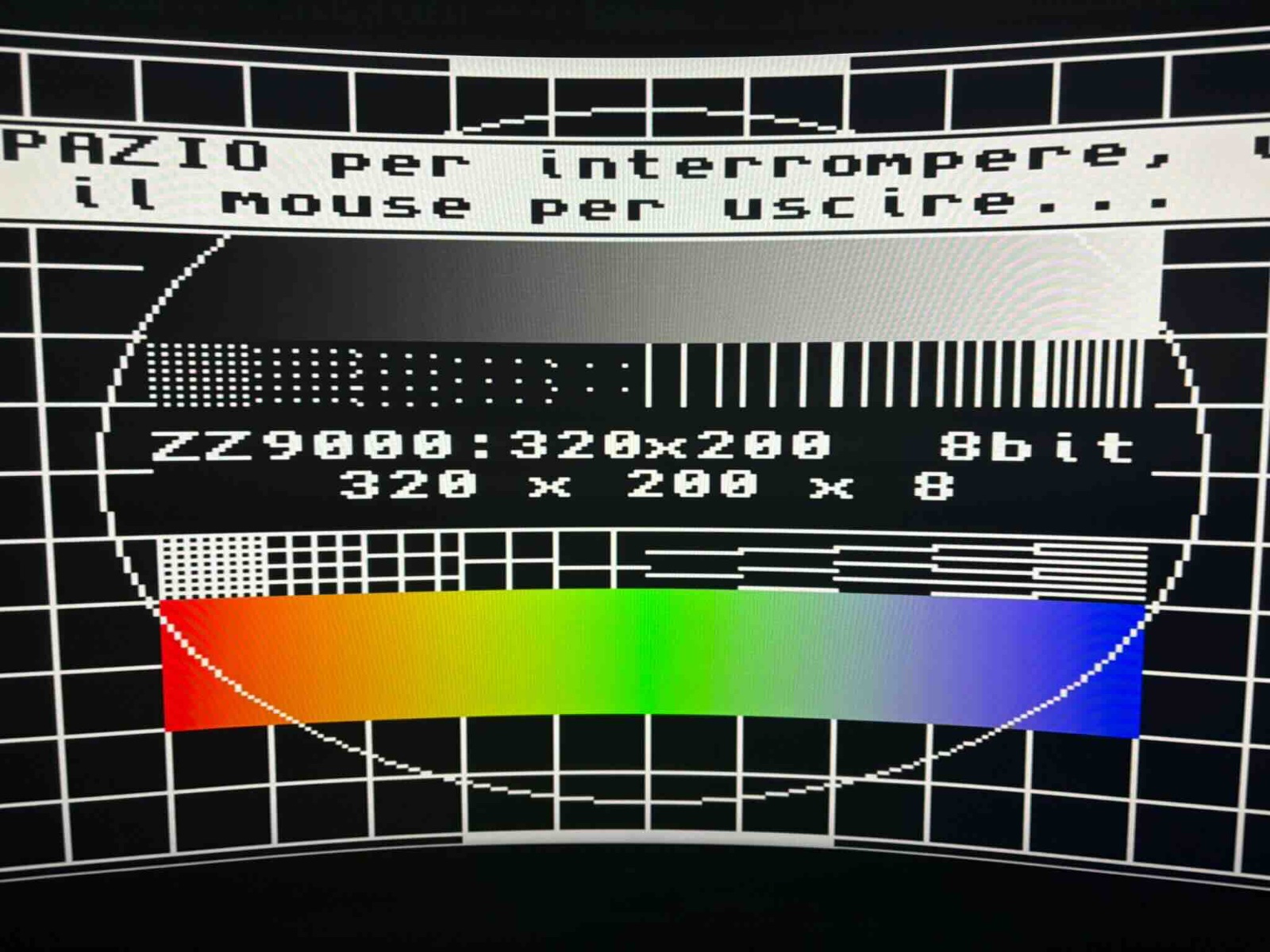

I tried another VGA-to-HDMI adapter, but it didn't work. On the Amiga, when connecting via HDMI—bypassing the VGA-to-HDMI adapter—the output on the monitor is perfect.

luciodra wrote: Thu Oct 22, 2026 5:18 pm I tried another VGA-to-HDMI adapter, but it didn't work. On the Amiga, when connecting via HDMI—bypassing the VGA-to-HDMI adapter—the output on the monitor is perfect.
Yeah that's a modern FPGA outputting to HDMI, likely having an internal scaler that outputs a standard HDMI resolution @ 60hz from whatever the source format is in vram.
Old PC graphicscards outputs 320x200 like so:
Vfreq = 70.086 Hz
Hfreq = 31.468 Khz
And that 70hz is the biggest contributor to making it incompatible with vga->hdmi adapters and some modern displays that don't have native VGA support. The odd by todays standard output resolution (640x400) doesn't help either of course.
640x400@70hz isn't something anything common will ever output over HDMI so it makes sense that HDMI-only products don't go out of their way to support it.
It's a decently well discussed issue on the PC retro side, as well as retro youtubers wanting to capture footage of DOS games, or even the MS-DOS prompt itself which is 720x400@70hz. Scalers are always an option but expensive if you have no additional use-cases for such a thing.
A tweaked version of 640x480@60hz should be easily doable and a good idea for improving compatibility. Effectively just enabling pixel and line doubling for an effective resolution of 320x240@60hz.
