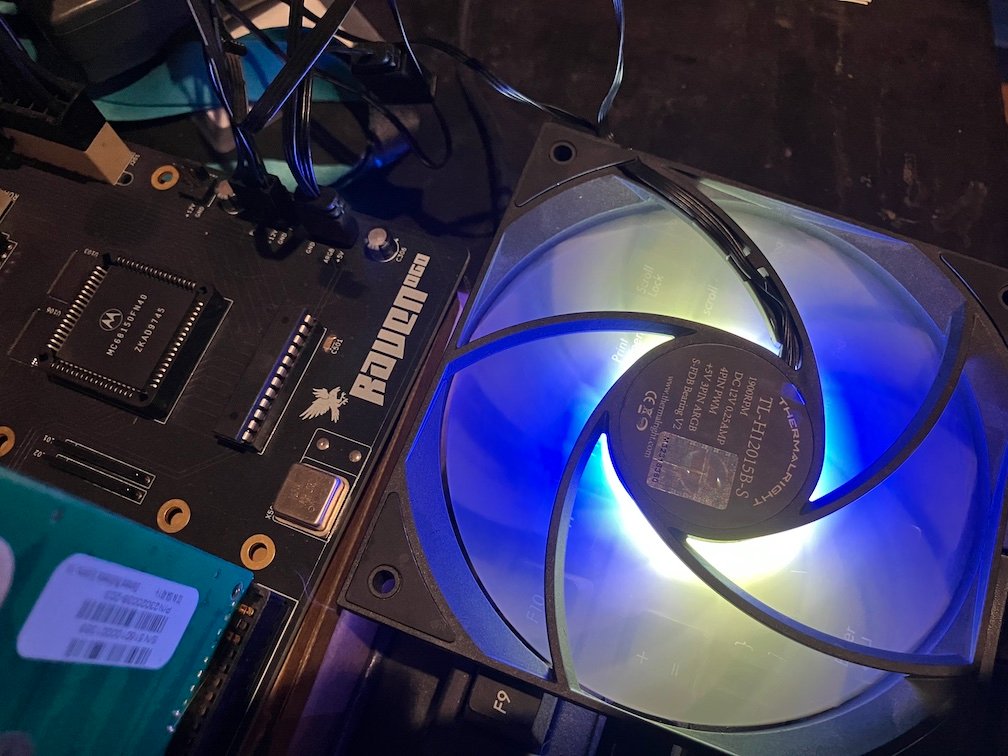

Took a while to get around to testing them but PWM and ARGB headers are functioning as expected.
I plan on exposing just some basic settings for this in the bios setup screen.
And an API that could be used by some dedicated argb software/tsr for fancier effects if someone wants to make such a thing.
Posts: 7679
That looks good and means I won't need an rgb controller on my next build.
