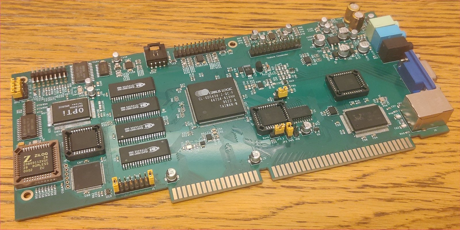

Just gonna put this here as it would be interesting to see if it works in the Raven... :D
Video, sound and networking a single ISA card.
https://pcmidi.eu/sonicvisionpro.html
SonicVision Pro is now available for pre-orders...

A great idea, 370 euros though

I guess the graphics drivers would need to be written on Atari, too. Networking shouldn't be a problem and OPL3 perhaps neither (thanks to @nokturnal's library).

Cirrus GD5434 is fully supported with hw acceleration with the rvnova svga driver :)

That's what a GD5434 ISA card can fetch on eBay on its own. Here you get a new card, sound card + nic for the same price.
If the Raven had only a limited slots, this would be a no-brainer. If this had interleaved memory, I might get it down the road...
