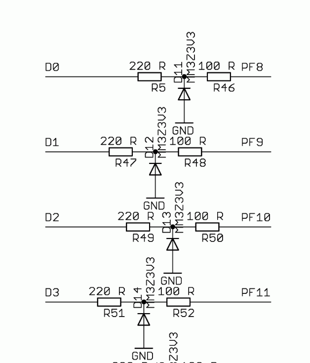

There are protection diodes connected to GND according to the schematics. But they are across voltage divider resistors.exxos wrote: Thu May 19, 2022 5:03 pm @stephen_usher Maybe they are just zener clamped to 3.3v ? Even so that wouldn't be good for the STE which has driver chips![]()

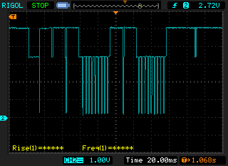

Nope this was inside the ST when I was trying to diagnose DMA issues.ijor wrote: Fri May 20, 2022 12:52 pmYou are probably measuring at the US end. As Exxos is saying, there is a protection diode that prevents voltage to raise above the threshold. Try measuring voltage at the computer end and it should be higher because there are voltage dividers. Anyway, the diode prevents higher voltages only, it doesn't affect the current when pulling down the signal.stephen_usher wrote: Thu May 19, 2022 5:00 pm Putting a 2.2K resistor to +5V doesn't shift the voltage at all, not even a centivolt, so whatever is pulling the lines to that value is very strong. Goodness knows how much current the DMA has to sink to pull them down for data transfer.

The gigafile did odd things. Sometimes it was 3.3V and other times 5V. I assume when it was driving the bus it was driving 3V by itself and not relying upon the pullups. I know Wolfgang had a lot of problems with the thing overall. Possibly he was driving the bus because the pullups were just inadequate to drive a logic high. And by adding the pullups solved a great many problems. So it would seem logical in driving 3V from gigafile in that respect. But things are slightly more complicated on the STE.

Indeed its clamped to 3.3V. But via a 220R. With pullups (DMA FIX) it would be like 10K clamped to 3.3V. But with driver chips like on the STE, 5v driven via 220R is like 22mA.. 114mW. Might be lower as I think the STE had 33R in series as well.. To lazy to check.
Not sure I follow why the 100R are in there. If its hard clamped to 3.3V, then you only need to drive low anyway. Maybe just noise immunity. No point in a voltage divider if your hard clamping to 3.3V anyway. I am assuming the chip is running on 3.3V. Even so, if the chip is driving high, then the 100R may make more sense as the chip voltage might be higher, say 3.5V depending on regulator tolerances. But anyway, getting off topic a bit.

I though the zener diode was more for voltage protection (may be also for hot plug-in) than for level shifting. But I assumed this was clamping to 3.3v after the voltage dividers at the device side only. If you are saying this will clamp the ST side as well? Then that sounds like a bad design to me.exxos wrote: Fri May 20, 2022 1:47 pm Indeed its clamped to 3.3V. But via a 220R. With pullups (DMA FIX) it would be like 10K clamped to 3.3V. But with driver chips like on the STE, 5v driven via 220R is like 22mA.. 114mW. Might be lower as I think the STE had 33R in series as well.. To lazy to check.
The US is driving high. Surely the output is not open drain, if that's what you mean. If the US output would be open drain, then it wouldn't work at all. Not even with pull-ups because a 10K pull-up is way too weak for this frequency. I think the pull-ups are mostly to reduce ground bounce and noise inside the DMA chip when the bus is idle, that otherwise would be floating.As I was testing my ultrasatan originally on my STFM, I will make the assumption that UltraSatan is not driving a logic high but relying on the pullups. If it was driving high then I probably would not have came conclusion that the 10K DMA pullups were needed to fix the problems with it. Of course I am reeling this off the top of my head I have not looked into all this for a long time.

If the US chip is running from 3.3V and not 5V IO tolerant ( I Haven't checked), then it would have to be clamped to 3.3V else it would otherwise blow the chip up as the ST side would be driving from 5V. If it was 5V tolerant then why bother with the zener anyway.ijor wrote: Fri May 20, 2022 2:59 pm I though the zener diode was more for voltage protection (may be also for hot plug-in) than for level shifting. But I assumed this was clamping to 3.3v after the voltage dividers at the device side only. If you are saying this will clamp the ST side as well? Then that sounds like a bad design to me.
D0 comes from the ASCI port, so 5V, via 220R clamped to gnd via the 3.3V zener. Then 100R to the blackfin chip which can only be 3.3V or GND.
If the blackfin was driving IO from 5V, then the output would still be clamped to 3.3V via the zener anyway. The 100R probably stops it from shorting 5V to 3.3V level.
But I haven't really looked into that series of chip, so don't know whats its IO capability is. Eitherway, like you suggest, just seems like a "poor mans level shifter" to me. I'm not a fan of clamping 5V to 3.3V even though its still classed as a logic high. By the time you have connections, cables, series resistors, noise etc in the mix, your probably boarding on the thing malfunctioning anyway.

I thought you said it was operating at open drain. I misunderstood what you meant by "high". Sorry. But indeed, the Blackfin is not 5V tolerant.exxos wrote: Fri May 20, 2022 3:28 pm D0 comes from the ASCI port, so 5V, via 220R clamped to gnd via the 3.3V zener. Then 100R to the blackfin chip which can only be 3.3V or GND.
Even for 500 KHz, a 10K pull-up is too weak for open drain output. Try running the floppy with 10K pull-ups.stephen_usher wrote: Fri May 20, 2022 3:28 pm ACSI doesn't run very fast, slower than the main ST bus, less than a megabit per second, so the rise times aren't necessarily that fast.
Yes, I was wrong regarding the clamping. I though it would affect the device side only. But anyway, the diodes are not relevant when the DMA chip is driving low and sinking current.Goodness knows how much current the DMA has to sink to pull them down for data transfer.
