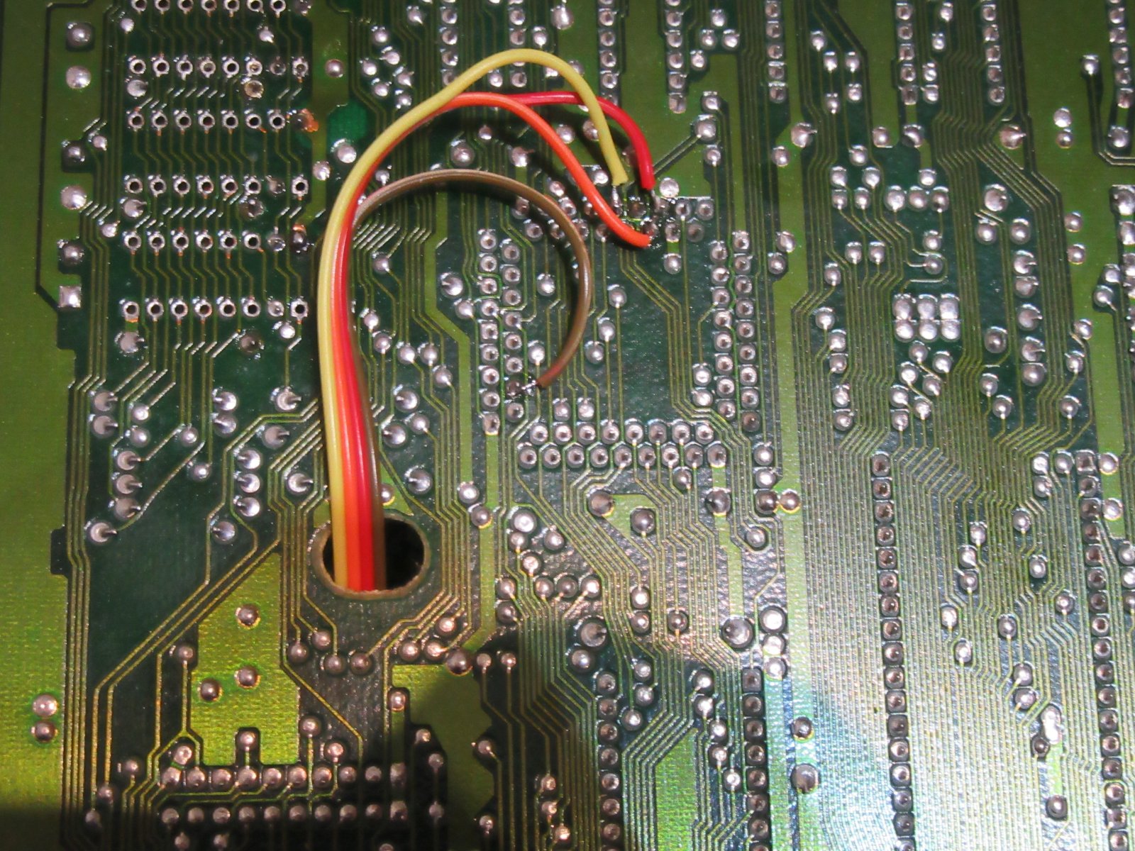

Posts: 28712
Re: STM 4MB RAM UPGRADE
My fitting..
