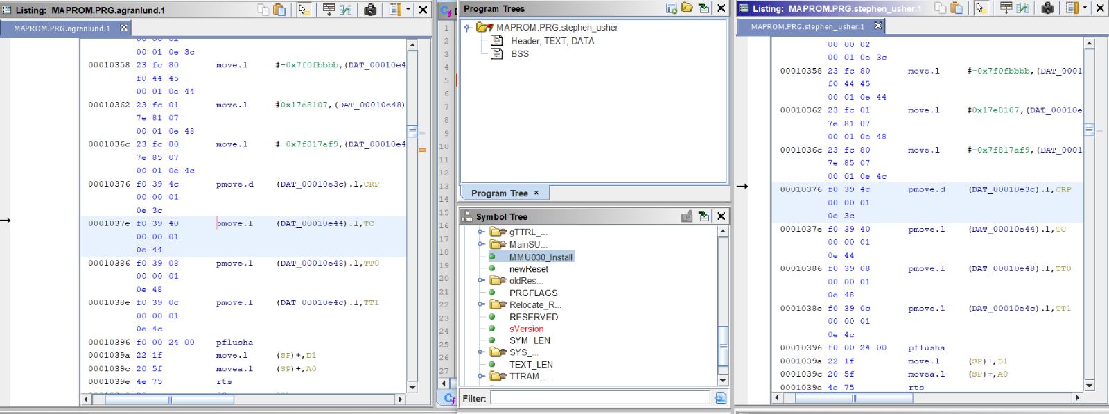

Re: Latest firmware stops PAK/30 from booting.
I'm not sure how this makes a difference, though. Anders's version (downloaded from his GitHub repo) and your version (attached to the forum thread) are 100% identical in this section of code:stephen_usher wrote: Wed Mar 03, 2021 3:40 pm This is the section I changed (commented out the original lines and typed in the replacements:Code: Select all
* dc.l $f0394c00,gMMU030_CRP ; pmove addr,crp * dc.l $f0394000,gMMU030_TC ; pmove addr,tc * dc.l $f0390800,gMMU030_TTR0 ; pmove addr,ttr0 * dc.l $f0390c00,gMMU030_TTR1 ; pmove addr,ttr1 * dc.l $f0002400 ; pflusha pmove.d gMMU030_CRP,CRP pmove.l gMMU030_TC,TC pmove.l gMMU030_TTR0,TT0 pmove.l gMMU030_TTR1,TT1 pflusha
(His version is on the left, yours on the right.)
I've no idea then. One binary works on my machine and the other doesn't.
