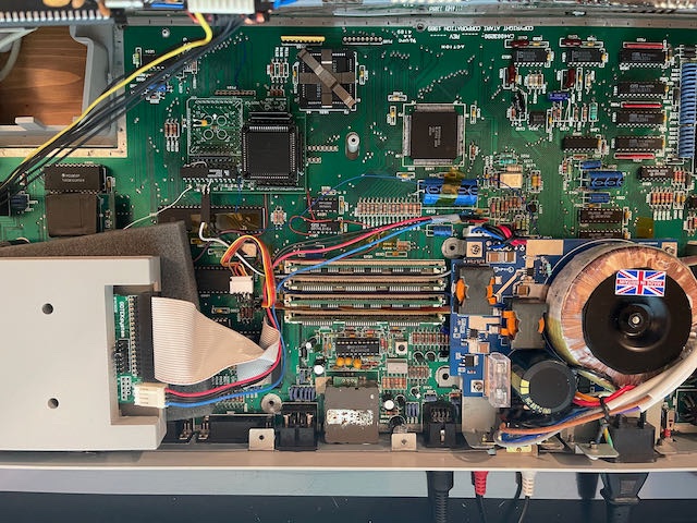

I simply used a thinner cable for the 32 MHz clock with a route far away as possible of the RAM (of course).
The only thing missing is to switch back to non-parity RAM and see how it goes.
But at the end of the day, I guess the DMA C025913-38 is doomed on some machines (with lot of noise on the data bus) and needs to be replaced by a C398739-001A.

I received a white cable with the booster but a little too short to reroute far away from the RAM.
Yup I followed the guide how to route properly the cable. https://www.exxosforum.co.uk/forum/viewtopic.php?t=20
