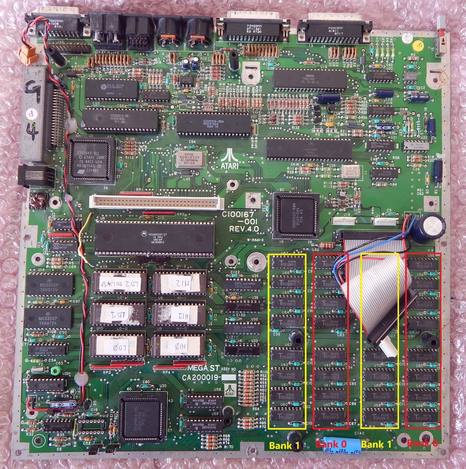

The last thing to sort is the oddest. The diag cart reports 4MB consistently now. It was flip flopping between 2MB and 4MB until I tweaked the MMU socket, now diag cart says 4MB consistently. BUT, the diag cart RAM test does report errors.
Running Sysinfo shows 2MB, with bank 0 seemingly ok, no sign of bank 2. More RAM tests required I think, and I do have lots of spare RAM if repairs are required.

Once the power instabilities are resolved, it's going to be working out why only 2MB out of 4MB is seen by TOS, so I'll run the diag cart memory test, see what's what.
If somebody more familiar with Megas than I am can advise on the memory bank layout for these machines, I'd be grateful of the help, as I'd only want to replace anything that is faulty, not everything.

Bank 0 seems fine then. Have you tested piggyback the ram chips on Bank 1? It might work depending on if the chip(s) that is faulty is not shorted inside. You just fit a ram chip on top with friction so that the legs touch each other. Depending on how many you have you can try piggyback all of them on bank 1. Otherwise just do 1 at the time and turn on the computer in between and test it with diagcart.
What does the diagcart says is faulty?
Bank 0:
U40= bit 0
U41= bit 1
U42= bit 2
U43= bit 3
U44= bit 4
U45= bit 5
U46= bit 6
U47= bit 7
U48= bit 8
U49= bit 9
U50= bit 10
U51= bit 11
U52= bit 12
U53= bit 13
U54= bit 14
U55= bit 15
Bank 1:
U60= bit 0
U61= bit 1
U62= bit 2
U63= bit 3
U64= bit 4
U65= bit 5
U66= bit 6
U67= bit 7
U68= bit 8
U69= bit 9
U70= bit 10
U71= bit 11
U72= bit 12
U73= bit 13
U74= bit 14
U75= bit 15
I think I got this right above. Hopefully someone will correct me otherwise.

Ok then,let's have a look at the RAM goings on I say to myself. Nope, PSU suddenly dies when I plug in the floppy, so I trace whats going on back to freyed power connections for the floppy. Ok,that's fixed. Now can we look at the RAM? Yes? Yaay finally.
SYSINFO shows bank 0 is working, so happy days:
Nothing at bank 1 though through TOS, but Diagcart shows 4MB installed, and test run shows the following:
So, based on the info DoG provided, it's U69 that is dodgy.
Next thing I need is some suitable RAM chips, since I have only STFM RAM chips spare, so I'll have to go on the hunt for TC511000P-10 chips so I can try a piggyback test.
