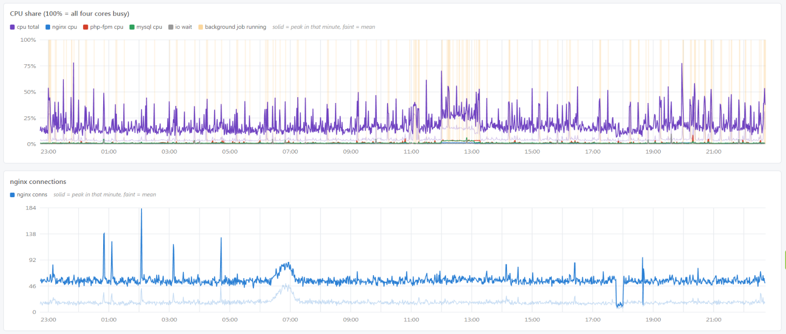

My new stats seem cool. Just trying to figure out why the bot net suddenly stopped again. Same as before, just seems to turn off instantly , for no apparent reason.

The crims probably ran out of funds to pay for the botnet service.exxos wrote: Tue Jul 14, 2026 11:21 am My new stats seem cool. Just trying to figure out why the bot net suddenly stopped again. Same as before, just seems to turn off instantly , for no apparent reason.
Re: Server updates
Could well be !stephen_usher wrote: Tue Jul 14, 2026 11:35 am The crims probably ran out of funds to pay for the botnet service.

Re: Server updates
Botnets never seem to appear when you want them to !
We been pretty mellow the past few days now.
The CPU spikes are "background tasks" running mostly. Generally just max out a CPU core for a few seconds. The connections is the interesting one... now its just a waiting game I guess again...
