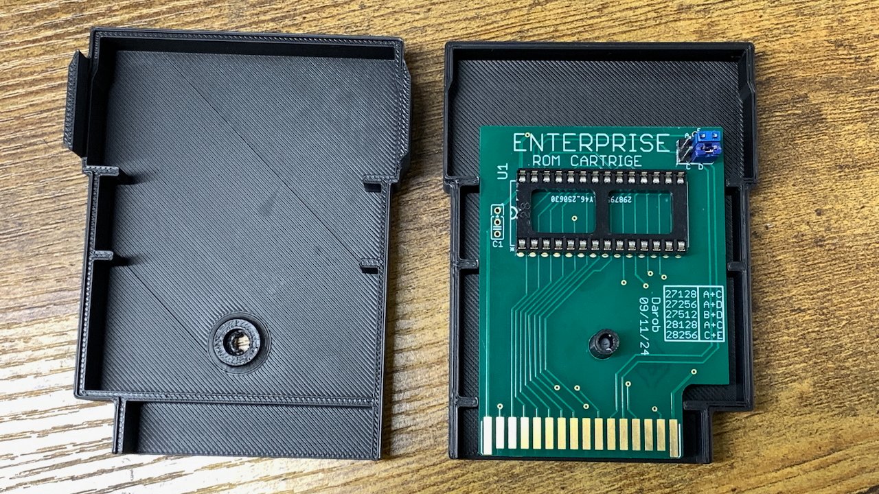

Having looked at photos I saw that my joystick handle wasn't the correct shape. It should be more like an inverted "modern" milk bottle rather than an inverted old milk bottle shape, so I designed, printed and painted a new one.
Whilst waiting for a package from "rabs" on the Retro Hardware Discord containing his RAM expansion and a PCB for a floppy interface I decided to design a ROM cartridge case. Amazingly there are no freely available STL files for a case but there are people selling them via eBay. Anyway, I gathered all the images I could find online, including a useful plan image of a PCB sitting inside an original case from which I could get good dimensions as I could use the edge connector spacing of 2.55mm as a reference. I had to guess the heights though and I didn't have a good image of the upper half.
This is what I've come up with. It still needs a little tweeking but once that's done I'll publish it on Thingiverse for anyone to use.
