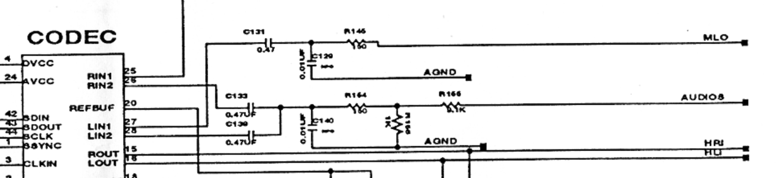

Yeah the relevant path is here - YM is mixed down to mono as AUDIOS.
This is then coupled to LIN2/RIN2 on the Codec, nowhere else. So it is always being digitized, in preparation for future Raven applications :D
