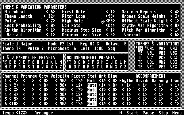

Tunesmith Tutorial
A Session with Tunesmith.
1. Double click on the TUNSMITH.PRG. the program opens. Once you get to the
main screen, press the space bar, or click on "PLAY". You will hear an
Acending scale.
2.Press any of the QWERTY keys or the numbered keys above QWERTY to hear a
scale that is assigned to that particular key stroke. Notice the Number keys
contain more "normal" scales such as Major, oriental, ect. The other key
contain scales based from other sources.
3.Press some of the function keys. these effect "model" changes in Tunesmith.
4.Press some of the 10-Key numeric keys. These change the Keys and Octaves of
the scales.Press " ( " key to get back to "C".
5.Go to the Themes Generator Window and RIGHT Click on TA. You will hear an
Algorithmic variation of the scale that you previously been hearing.
6.Go to the Theme and Varaition Parameter Window. Set Microbeat to "6", Pulse
to "2", Rest probability to "0", Rythm Algorithm to "1", and Variant to "1".
7. RIGHT Click on TA again. You will hear a more constant phrase being
generated.
8.Go to the Accompaniment window to the Status line and click on the second
Mute
Button to Un-mute it. You will hear an identical line coming out in unisyn.
9. Go to Harmony on the same window , click on the first line and change it
to
"4". You should hear some harmonies being generated from the original phrase.
10. go to Program in the same window and change the values of channels 1 and
2
untill you find an interesting combination.
11. Click in the letter "B" on the Accomplanament Preset Window. This saves
the
accompaniment you have just created to a preset for later recall.
12.On the Themes and Variation window, click on VA1. You should now hear a
variation of TA. Click into TB. This will create another Phrase or Theme.
13. EXPERIMENT: Change parameters in the theme and variation parameters
window.Then click into TC to TE areas in the Theme and Variations window to
hear what Themes (Phrases)your new settings create. Unmute more voices and
experiment with program changes, types of harmony, octave, velocity, accent,
and articulation. Save your settings as a preset in the Accompaniment preset
window..Try changing the channel number to 10 (drums) and the harmony types to
get different drum patterns going. Click into anything to see what happens
14. Hit backpace to stop playing, or use the mouse at the botton of the
screen.
15.You can get HELP by hitting the HELP button and all the commands and
algorythms are listed for your viewing pleasure.
16.To change the screen colors go to the MENU and select CHANGE COLORS. A
dialog appears for you to do just that. Once you are done, save it as the
DEFAULT.TUN, and your color scheme will be saved.
17.To change other settings, go to MENU and select SET OPTIONS. Here you can
select for midi thru (or merge) to be on, change mouse cursers,(mouse
pointer)and other stuff.If you want these setting to be there everytime you
start Tunesmith, save it as the DEFAULT.TUNE.
18. Also within the Menu is EDIT SCALES. First select a QWERTY key you want
to edit the scale from. Go to MENU, then EDIT SCALES.From there you can use
your Midi keybrd to input a new scale, call it what you want and save it it
indevidually to disc, or go OK and when you save the overall TUN, it is saved
in that tune.Some of the other menu Options are Obvious. Just explore those
Options.
19.Have Fun with Tunesmith!

One of the unique thing about Tunesmith, besides creating themes and accompliments, is it's TONALITY SECTION. This is one of the Genuies of Jim Johnson, as he integrated many ideas in the Tonality section of Tunesmith.
Just as a starting note: It might be interesting to know where Jims original ideas came from for Tunesmith. The seed was planted from an article in "Contemporary Keyboard" called "Automatic Improvisation with Modular Synthisisers" by Roger Powell(former keyboardist with Todd Rungrens UTOPIA band as well as a creating his own sequencing software called TEXTURE)The Tonality section ideas came from a book called "Music Possable" by Stan Jungelieb, then director of publications at Sequential Circuits.The concept of Microrhythms came form Jack Citrons book "Cybernetic Music". Looks like a lot of heads came together to bring us this program.
Tunesmiths Tonality sections includes 4 clusters of keys on the computer keyboard.These four sections determine which notes Tunesmith will use at any given moment as it converts it into actual Midi Music.
1.SCALES: Every key on the qwerty keyboard starting at numerical key 1 to 0 and q to / can be assigned a different scale. There are 46 default scales. The first 38 scales are derived from the scale clasification as set out in the book called "Music Possable" by Stan Jungelieb. The rest are "user scales" However, any of the scales can be over written with user scales. (See CREATING USER SCALES)
The keys in the Top row select the more common scale families: major, minor, ect. the further you move away from the 1 key, the more exotic the scale is.The 5th help screen (Just select help and click 5 times)shows a list of all the default scales. Once you get into tunesmith, you may want to try creating your own scales, or inputing a pattern of notes that Tunesmith can use as its pitch structure, and not nessisarily a scale.Load the VOYAGE.TUN for an example of this.
2.MODES. The Function keys F1-10 This selects a MODE that the scale can be altered to.
F2- the first mode:equivalent to the scale itself
F3-selects the second mode, ect up to
F8 which select the 7th mode.
F1-selects the 7th mode one octave down
F10 selects the 2nd mode one octave up.
The best thing to do is start Tunesmith playing in a MAJ scale (no 1 on the top part of the keyboard)and start hitting the Function keys to hear the results. From there you can be more selective. You can create a whole arrangment with just alternating Modes. Most Jazz music has discovered this, instead of changing keys.
3.KEY Selectors: These are the 12 keys at the top of the Numerical keypad at the far right side of the computer keyboard .The "( " key is the beginning .Going to the left, it transposes the scale selected up one semitone.
4. OCTAVE selectors: On the Numerical keypad, the 1,2,3,0,and . keys deturmine the octaves. the "0" key is No transposition. The "." key transposes DOWN one octave. "ENTER" transposes down two octaves. The 1,2 and 3 keys transpose up by one, two and three octaves respectivly.
USING THE TONALITY SECTION
This is where Tunesmith can be an interactive instrument, by selecting different Modes, scales and kets as well as changing octaves on the fly.All of these actions can be recorded using the ARRANGER mode.
Try sticking to one or two scales, and then changing the Modes as well as being very selective in the KEY settings. You can create an entire arrrangement from using changing these parameters IN REAL TIME.
Let me stress that THIS IS A REAL TIME PROGRAM Which brings us to the point why Jim Johnson did NOT use GEM is programming Tunesmith. Gem would be too slow in a real time situation, so he purposly avoided it.
Once you get used to the Tonality section, it becomes a lot of fun to create interesting accomplments that you can use in your own creations.
Midi Control of Tonality.
1.Open Tunesmith
2.Go to menu, and select SET OPTIONS.
3.You will see the many options and 'toggles" available for you.
You will see an option called MIDI CONTROL. Select it so it is highlighted.
4.Right across from it you will see a dialog that says:MIDI CONTROL CHANNEL. If it is not set to channel 1, change it to reflect this.This presumes that your keyboard controller is set to TRANSMIT on channel 1.
5.Select OK, and you are back to the Tunesmith screen.
6.Either load up a TUN file (Menu/Load Tune)or create a new theme. In other words, get tunesmith going by pressing the space bar and clicking on START.
6.You can now select keys on your midi keyboard and this will control the Tonalities as well as the keys!
7.Here is the MAP:
The ten white keys centered on the second octave of a standard 5 octave keyboard (B2-D4) selects the MODES.
The 11 keys in the second octave from the top of the keyboard (C5-B5) select the key.
Using Tunesmith under Midi Control opens up a lot of LIVE interaction possabilities. It is easier to vusualize the modes and what they do and turns Tunesmith into more of a performance tool then a generator of phrases.
Creating Custom Scales in Tunesmith
1.Once you open the program, select the Q key on the computer keyboard.The Tunesmith display should read "SCALE: Q A3."
2.Select MENU at the bottom.Now select EDIT SCALES.
3.The EDIT SCALES dialog appears.
4. You will see the SCALE KEY which refers to the qwerty key assignment. In this case, since we had selected Q previously, you see KEY SCALE Q in the dialog. The Name is A3.
5.Go to your midi keyboard and play a scale.You will see the notes in the dialog change to the notes you are "writting in" on your midi keyboard.
6.Select A3, and now you can rename the scale to your own imagination.
7.Down at the bottom of the dialog is OK, CANCEL,LOAD and SAVE. You can save this scale indevidually and use it latter. OR select OK, and the scale is writtrn to the letter Q. Then when you save the TUN, the custon scale is saved with it.
8.Click on SELECT SCALE. A dialog asks you to "select the scale key". Select another letter on the qwerty keyboard. Without leaving this dialog, you can reprogram all the scales used on the qwerty keyboard.
9.APPLICATIONS: You can either program some unusual scales and create a library of scales structures in which to choose from.Or you can actually create a "pattern" which is not a scale, but say a BASS LINE or melody. If you program different patterns for each key on the qwerty keyboard, you can easily build many compositions based on this library of patterns. If you 'randomize" the patterns using the Theme generator, it even gives you more possabilities.
