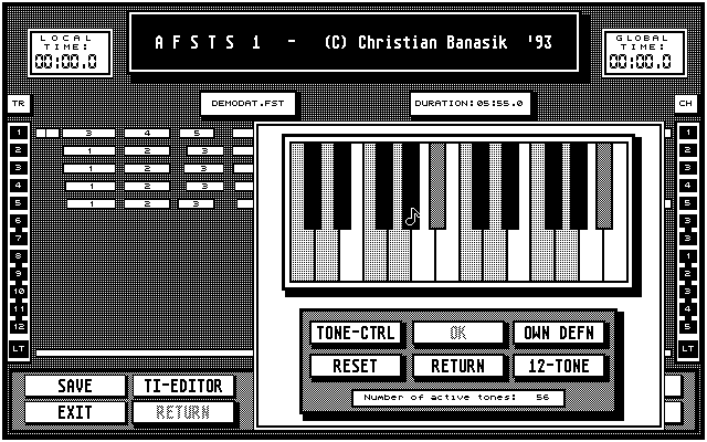

3.Right now you have an EMPTY screen with no tracks written.Click on the TONEMAP and a dialog appears with a keyboard graphic.The TONEMAP is what pitches will be used in generating the music.
You have several choices. RESET will mask out whole scales.12-TONE will default to a Chromatic scale.TONE-CTRL allows you to see the map of the scales in a seperate dialog.OWN DEFN allows you to create a scale which is what we will do.
Click on OWN DEFN, then click the keyboard on one of the "white" keys. It should grey out.Click on ALL the white keys. What you are doing is setting up a mask so the program will only pick notes from the "black" keys: that is a pentatonic scale. (so our example will sound "pretty" )In other words: whatever you select will NOT be part of the scale.When completed, hit OK. Notice the dialog at the bottom (Number of active Tones ) went from 97 to 40.Now click on RETURN.You are back to the track view.

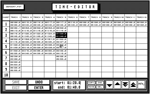

4. Click on TI-EDITOR, the Time Editor screen appears.Click on EDIT. The curser turns into a pointing hand. Click on the grid at location 1-Track 1 (the numbers)You will see the START and END numbers appear in the "editing box" at the bottom of the screen.Click in that box and change the end time by scrolling with the arrow keys and backspace to create: 01:00.0. This means our track will be one minute long.Then select ENTER with the mouse or just hit RETURN on the keyboard. It brings you back to the Edit Mode. Now RIGHT CLICK on the mouse. This will take you out of editmode

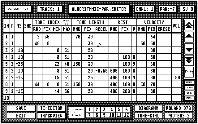

5. Click on TRACK 1 at the top of the screen. This will bring you to the heart of AFSTS: The Algorithmic Parameter Editor.
Go to the top Right and click into CHNL (Midi channel) and set it to 1. Possable entries are 1 thru 16
You also have PAN which allows you to place the sound in a stereo field.You can choose +7 to -7.
Starting on the far Left of the grid you have IN (Insert). You can have 25 inserts that can have their own Time definitions (that are set in the Time editor)We will be working on Insert 1.Now click into the P colomn for insert number 1.
P: Possable choices are 1, 2 or 3. This sets up an algorithm. See HTML manual for specs. For our example, enter 2. Then use the TAB key to go to the next line:
MS: Melodic Structure.Chooses an algorithm for melodic structure. Possable numbers -99 to +99. .For our example, enter 20. Use the left arrow key or backspace to scroll to the left, then enter the number. Clicking on the MS box itself will bring up a screen showing the algorithm. Just hit RETURN to exit out of the dialog. Tab over to:

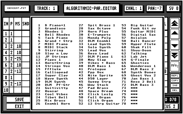

SND: Sound or Patch. Initiates a patch change. If using a general midi module, back space twice, then enter 13 for a mirimba sound.
Next you come to 4 areas that will allow you to control what AFSTS outputs. These areas are TONE INDEX, TONE-LENGTH, REST, and VELOCITY.
TONE INDEX
RND: Random or varaiable number of tones
FIX: A fixed number of tones
For our example enter 10 for both of these values
MIN: Minimin number of tones
MAX: maximin number of tones
These set the highest and lowest notes You can only use as many tones there are in the scale.In the TONE INDEX box it tells you how many tones you can use. For our example it says 40. Now enter 10 for MIN and 35 for MAX. (However..if you were programming a bass part you could put MIN 5 and MAX at 10...understand the concept?)
TONE LENGTH
RND: Variable length (0-999)
FIX: allows to set a FIXED length for the note. Shorter numbers create faster notes. For our example put in 40. Leave the RND blank.
ACCEL: + values plays the tones faster. - values playes the tones slower. For our example enter +10
REST
RND: Random Rests are created. Enter 10 for the example .
FIX: Allows a fixed number of rests. Enter 2 for the example.
P: allows you to select an algorithm. 1,2 or 3. Enter 2 for the example.
VELOCITY
RND: Random values for velocity (Volume)Enter 5 .
FIX: a fixed velocity vlaue (0-127) Enter 120.
CRES: Cresendo. + values increase volume, - values decrease volume slowly. For the example leave this blank.
VOL: overall volume limits (0-127) leave this blank.
Click on DIAGRAM. It will show you a graphical view of what we just did.Click on any key to return to the Algorithmic Parameter Editor. NOW click on TRACKVIEW.

Now you can start all over again with another track. Select TI-EDITOR, and go into edit mode, select Track 2,select your stopping point, select TRACK 2 at the top of the screen and put in parameters in the Algorithmic Parameter Editor and keep on going. Try it for midi channel 10 and use percusion sounds.
